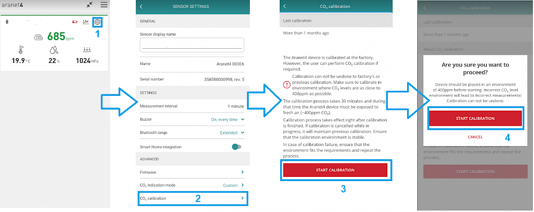

Please try recalibrating the device as shown in the video: https://www.youtube.com/watch?v=CD8E6WzpvjM except put the sensor in a full outdoor environment during the calibration process for 15 minutes without any person in close proximity.

Posted: 21.02.2021 14:30
Ok that is very good to know becuase for 7 months of the year our outdoor temperatures are < 15 C so calibrating outdoors will not be possible. We will look for a temperature-controlled indoor facility with a large fresh air draw and no humans about.
Posted: 21.02.2021 17:36
If possible then the most accurate calibration will be performed if the Aranet4 device can be placed in a closed environment filled with 420 ppm CO2 concentration level reference gas during the calibration process.
