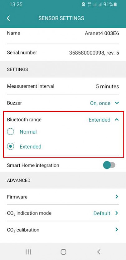

- If the sensor is located at some distance from you, consider switching On Bluetooth "Extended range" or moving closer to Aranet4 device:

I'm using the last update and I already tryed the extended Bluetooth...?

- Setting the Bluetooth range to Extended.
