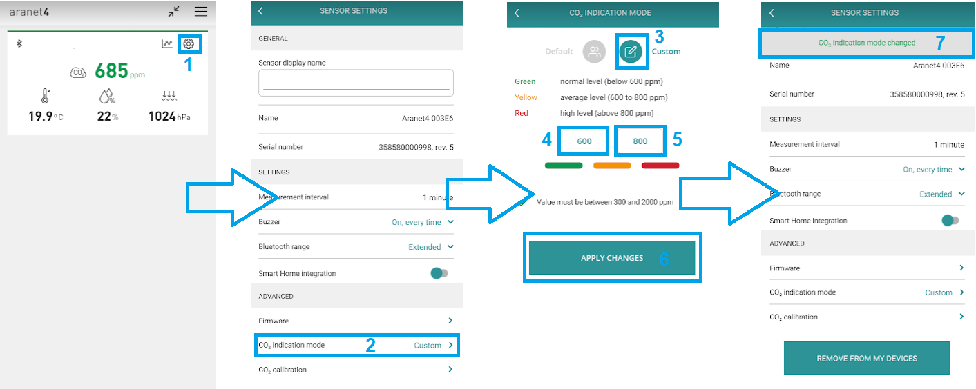

Starting from Aranet4 app version v2.0.4 it is possible to change color indication threshold levels for CO2 concentration measurements, here only additionally firmware of the Aranet4 devices should be updated to version 0.4.3 as described in https://forum.aranet.com/all-about-aranet4/how-can-i-update-aranet4-device-firmware/
From the Aranet4 application it is possible to change the value for both yellow and red threshold levels of the Aranet4 device in the range of 300 to 2000 ppm.
To configure these levels in the Aranet4 application please:
- Click on the settings “wheel” icon in the record of the necessary Aranet4 device;
- In the newly opened page click on section CO2 indication mode;
- Select Custom indication mode;
- Set Yellow threshold value as necessary;
- Set Red threshold value as necessary;
- Save settings by pressing on APPLY CHANGES button;
- In case new threshold levels were successfully configured, then the Aranet4 application will show a success message CO2 indication mode changed.

Yes, indeed - starting from Aranet4 app version v2.0.4 it is possible to change color indication threshold levels for CO2 concentration measurements.
