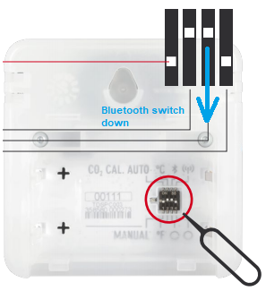

If the user does not need the Bluetooth connection, then it can be turned off by changing the position of the appropriate jumper switch in the device battery compartment:

Hi,
I just received my Aranet4 and it is not showing the Bluetooth icon. I tried removing the batteries, turning the bluetooth switch to OFF, then back to ON, and replacing the batteries. However, it is still not showing that Bluetooth is on.
Posted: 07.06.2022 15:05
Modified: 03.06.2025 12:35
Hi,
Thank you for using Aranet4!
The current Aranet4 version does not have a Bluetooth icon on the screen. Please refer to User Manual, p.2: https://assets.aranet.com/documents/aranet4_user_manual_v25_web.pdf
