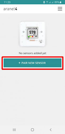

2. Launch Aranet4 app.
3. Stay close to your Aranet4 sensor and press “+ PAIR NEW SENSOR” button:

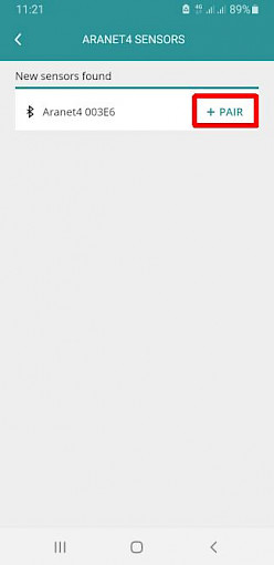

4. When the application discovers your Aranet4 sensor, press “+ PAIR” button:

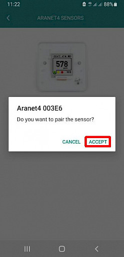

5. Press “ACCEPT” button when the system asks for permission:

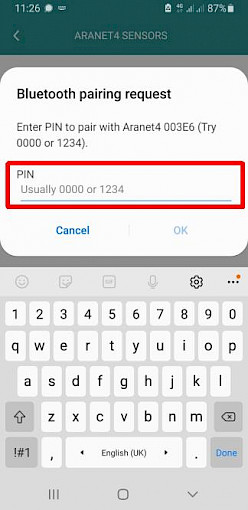

6. At this moment Aranet4 sensor will show 6-digits number on its screen, this is the PIN-code you should enter into application screen:

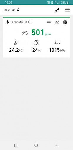

7. In few seconds Aranet4 sensor should be paired to your phone:
