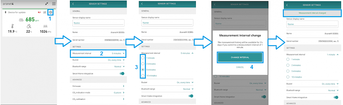

How to change the measurement interval on Aranet4 device?
Posted: 27.01.2021 23:32
Modified: 23.10.2026 23:24
It can be changed from the Aranet4 app as shown in the picture below:
