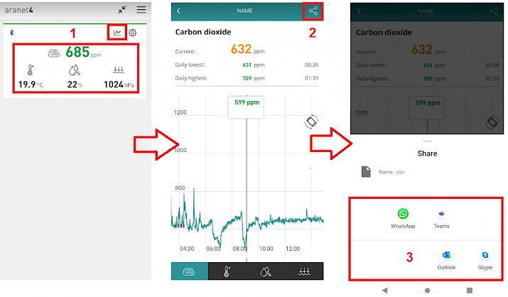

Aranet4 measurement data can be exported and shared/downloaded from the application as follows:

The updated version of the Aranet4 application is published both on Google Play and App Store, so please update Your local app version on Your device to have data export/sharing functionality. Once the application version is updated itself, please update also the firmware of the Aranet4 device as described: https://forum.aranet.com/all-about-aranet4/how-can-i-update-aranet4-device-firmware/
In the new application version data can be exported and shared/downloaded as follows:

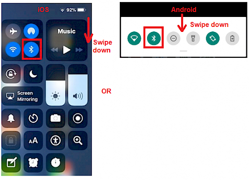

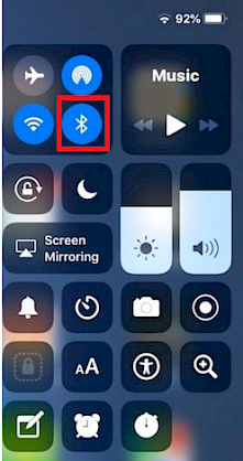

As a workaround could You please try disabling and enabling the Bluetooth adapter from the iOS Control Center menu when the Aranet4 app is opened and active. Such operation will re-establish Bluetooth connection and advance with data export/download process:
We continue working on the Bluetooth connection stability improvement in further app development and in future app versions it will be more improved and made more stable.

As for now when Bluetooth connection crashes, then it can be restored in one of 3 ways:
- Restarting the phone;
- Restarting the app as in the video: https://www.youtube.com/watch?v=A4cdZkeuhIw;
- Disabling and enabling Bluetooth adapter from iOS Control Center menu or Android Control Panel when Aranet4 app is opened and active:
