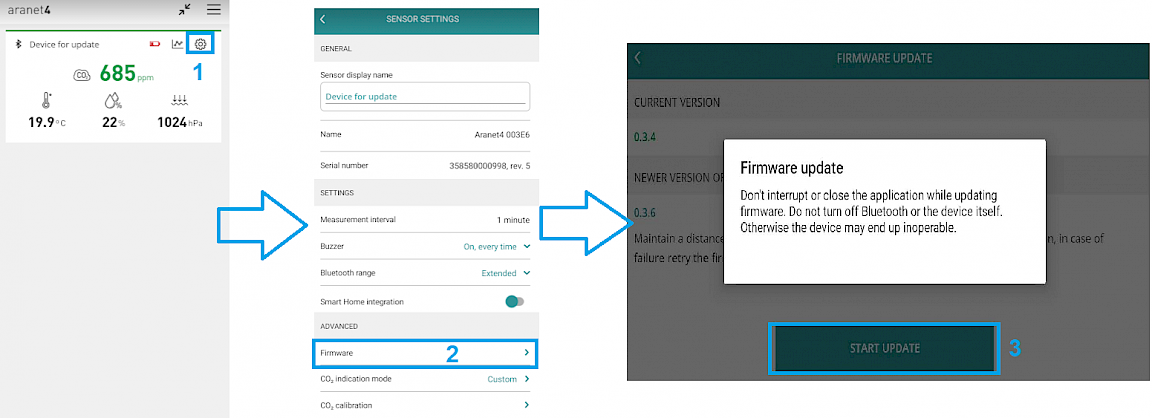

Starting from Aranet4 app version v2.0 firmware update can be done as follows:
- Click on the settings “wheel” icon in the record of the necessary device;
- In the newly opened page click on section Firmware;
- Finally click on the button START UPDATE:

Where can I find release notes for the firmware? I current have 0.3.9 installed and 0.4.3 is available. What are the changes?
PS: the screenshots no longer match the new UI in the app.

Thanks for the message and remark on the outdated firmware update process description - the correct process is described below.

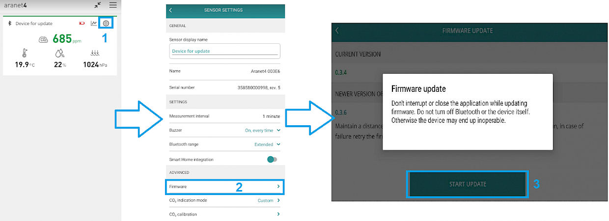

- Finally click on button START UPDATE:

Those screenshots don't seem to match the current interface still. The settings "sprocket" in the upper-right corner is not visible.
