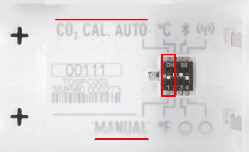

When doing a manual calibration the Aranet4 device must be exposed to fresh air (about 420 ppm of CO2) and the environment should be stable (not changing) for 30 minutes while the calibration is done. Maintain a distance of at least 1 meter from the device during the calibration process so the CO2 from your breath wouldn’t impede the calibration. To initiate the manual CO2 calibration change the switch position at the back of the device behind the batteries from MANUAL to AUTO and back to MANUAL (maintain a maximum of 1 second between each movement):
Please note! The batteries must be inserted into the device. To trigger the switch, use SIM-tool delivered with Aranet4 or another similar tool.
The calibration progress will be displayed on the screen of the device. In case of a calibration failure message, make sure that the environmental requirements are met and repeat the process from the beginning.
