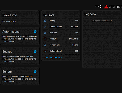

Aranet4 devices are now supported by Home Assistant Home Assistant (home-assistant.io) smart home automation platform.To enable Aranet4 integration please ensure that you have Aranet4 device with firmware version 1.2.0 or newer and Home Assistant version 2022.12 or newer and Bluetooth capability.

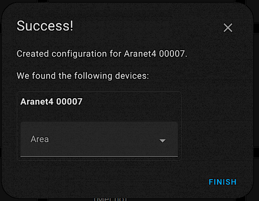

Initial configuration seteps:

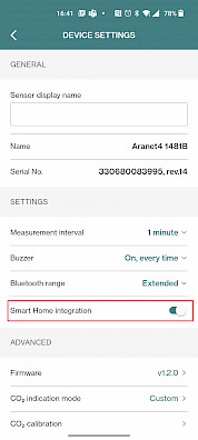

- Before start using integration please configure Aranet4 device using Aranet4 App - enable Smart Home Integration in Aranet4 App device settings

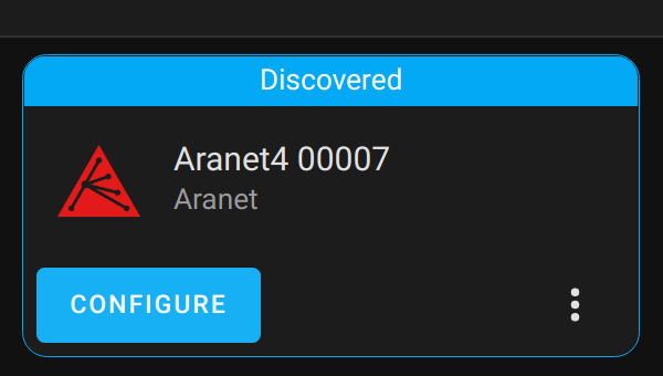

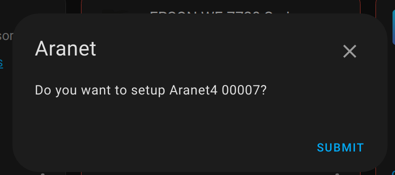

2. Download and set up Home assistant Aranet integration - Please read the instructions for setting up Aranet Integration on Home Assistant

Aranet4 is using BLE (Bluetooth Low Energy) communication protocol which has limited range. Please ensure a close distance between Aranet4 and Home Assistant hdevice to avoid connectivity issues. To improve connectivity you can select Extended blouetooth range option in Aranet4 App device settings.
