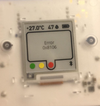

Aranet4 error 0 x 8106
Posted: 02.07.2020 14:51
Modified: 23.10.2026 20:37
Error 0 x 8106 indicates that CO2 sensor is malfunctioning. In order to resolve the issue:
- Try manually re-calibrate the CO2 sensor
- If the problem persists, fill the RMA form

I do not necessarily think this is the correct behavior. My experience indicates that in super crowded bar environments, where poorly ventilated, the numbers may actually climb above nine or ten thousand!
Posted: 06.07.2021 05:53
Hi ariccio,
Aranet4 CO2 sensor measuring range is 0...9999 ppm. Higher CO2 values can cause the error or even damage the sensing element.
