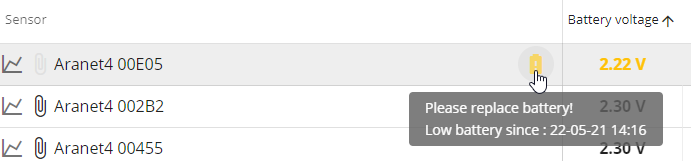

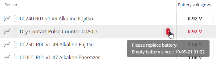

Low Battery alarms are turned on if the last 24h average battery voltage measurements are below the thresholds. Depending on Aranet Cloud User configuration settings, the battery voltage can be expressed in volts (V) or percents (%). Each sensor type has its own threshold settings.
Temporary Low Battery alarms can be raised due to temperature and corresponding battery(ies) voltage drops. Such alarms are resolved when temperature and battery(ies) voltage rise back.
Low Voltage Alarm is displayed:
1. Next to the name of the sensor as a battery icon of the color corresponding to the severity of the alarm. The battery voltage measurement in the table in this case should also be the same color.

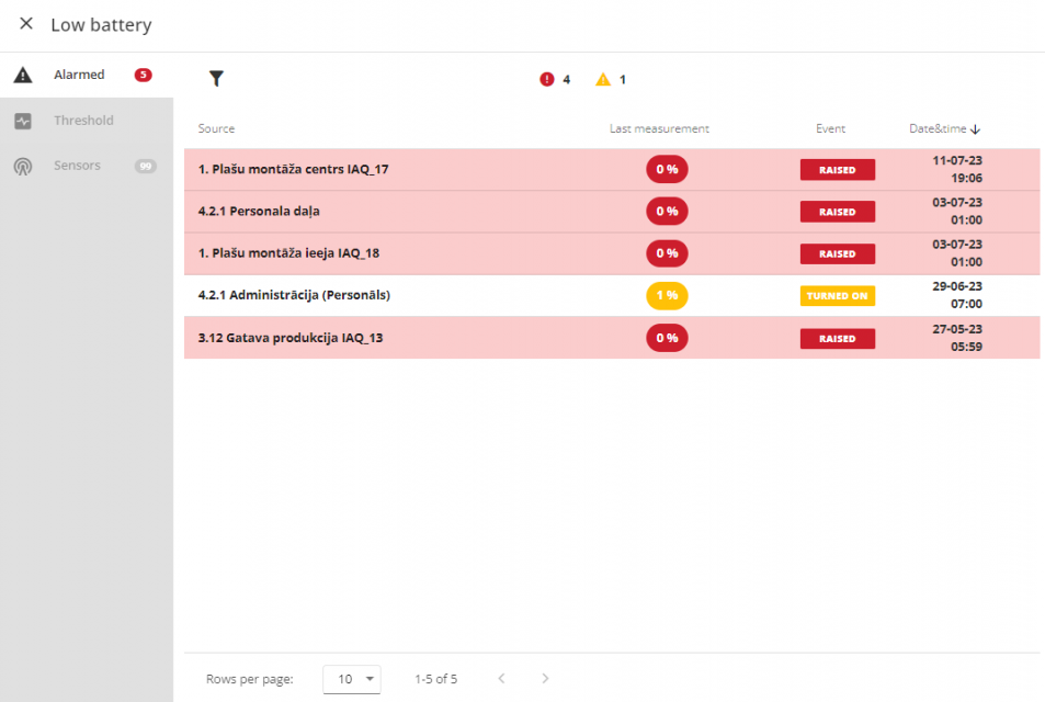

2. In the list of active alarms (if an active battery alarm exists) and in the alarm history (if events exist).
3. In the list of active sensor alarms (if an active battery alarm exists) and in the alarm history (if events exist).

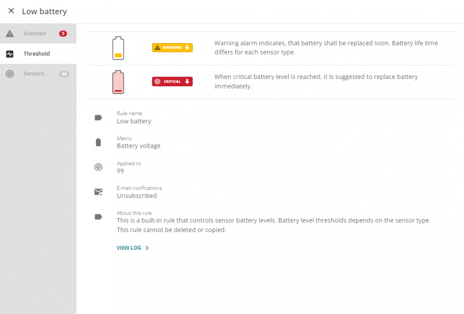

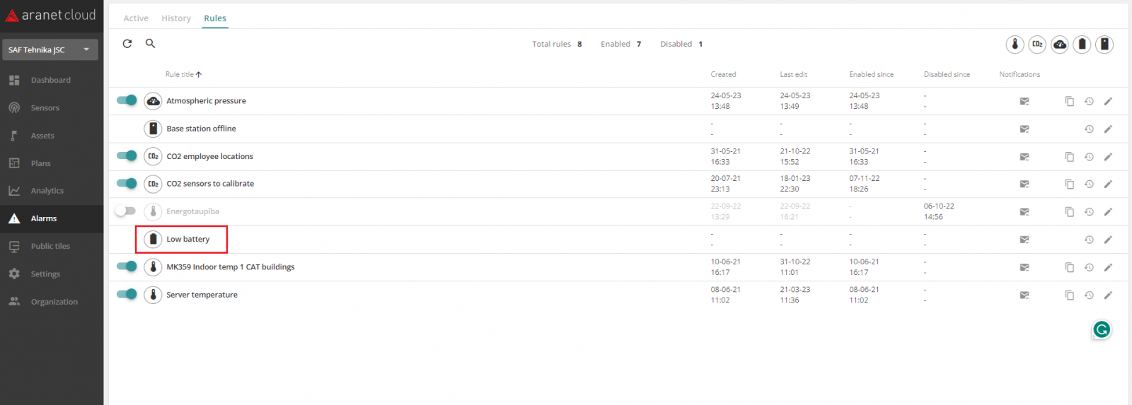

Also you can find all this type alarms in the Alarms -> Rules section.
By clicking you can see thresholds descriptions and list of alarmed sensors.
