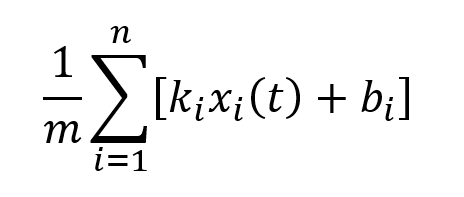

You can select an Expert template when creating a Virtual sensor in the Aranet cloud:
This formula represents calculations to be made with measured data of up to 10 sensors. All input sensors must have the same metric. The result of calculations will have the same metric as input sensors.
Formula variables are:
- x(t) - input sensors measurement, unit is defined by sensor's configuration;
- k - slope, a real number in the range of -1e+10 to 1e+10;
- b - offset, the same unit as input sensor;
- n - number of sensors, min = 1, max = 10;
- m - normalizing factor, a real number in the range of -1e+10 to 1e+10, must not be equal to 0.
Indeed, Offset, Average and Sum are special cases of Expert formula.
