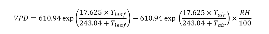

Vapor-pressure deficit (VPD) is one of the methods growers use to measure humidity in a greenhouse or growing environment. It allows growers to gauge the impact of humidity on plant growth and development.
VPD in Aranet Cloud is calculated according to the formula:
,where
The default metric of VPD is kPa.

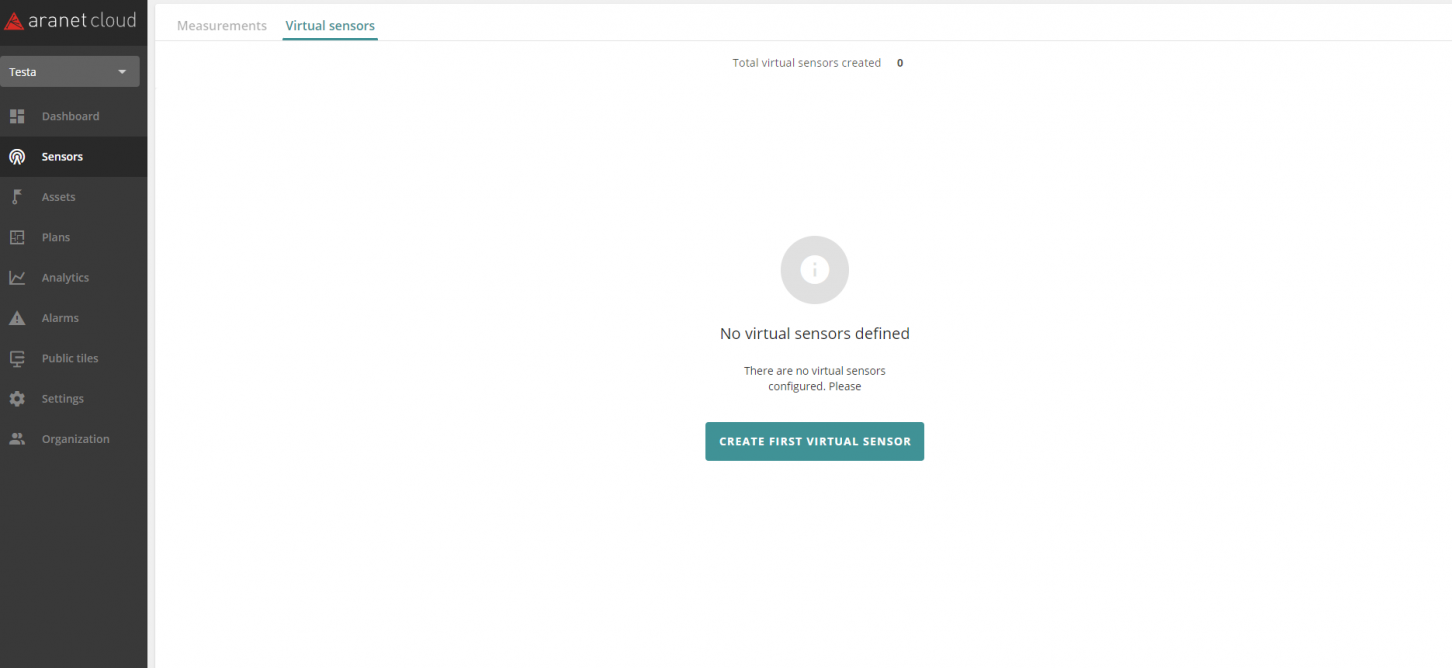

To create virtual VPD sensor navigate to SENSORS menu -> VIRTUAL SENSORS tab and press NEW VIRTUAL SENSOR button:

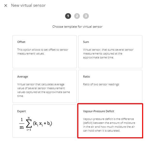

Select Vapour-pressure deficit sensor:

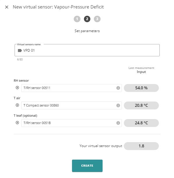

Give sensor a name, select source sensors and press CREATE button:

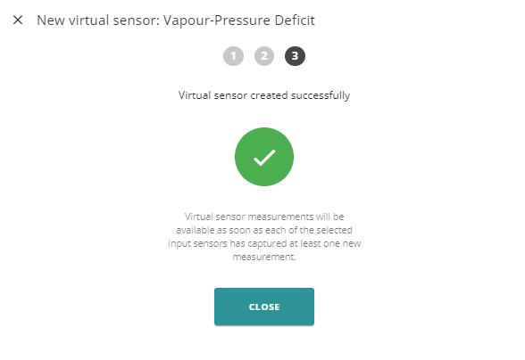

Sensor creation is finished:
