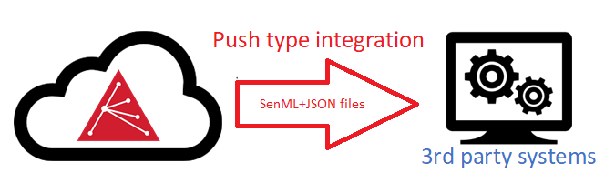

Currently from the Aranet Cloud platform we provide 3rd party integration possibility via its SenML push API. Integration configuration for data send-out can be created on Aranet Cloud workspace and then the system will send out .json files with sensor data in SenML structure according to RFC8428 https://tools.ietf.org/html/rfc8428 to the server (endpoint) which is capable of receiving and saving such data. The server (endpoint) should be set-up by the user and we can not give any precise recommendations on this setup as there can be many different implementations. For more details on configuration on the Aranet Cloud side see: ARANET CLOUD INTEGRATIONS
Can You use such API to access data from Aranet Cloud?
If You are looking for a pull-type data requests, then Aranet Cloud API is what you need: Cloud API
