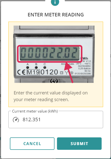

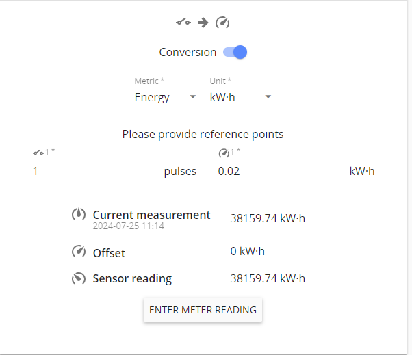

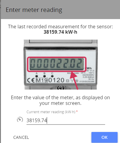

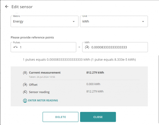

Starting from base FW version 4.4.4 and Aranet cloud version 2.0.68 you can add an offset to the cumulative pulse count.
In the base station, you will find a new button when looking at the pulse counter settings: "ENTER METER READING".Additional information regarding the pulse counter offset is available in another topic: Pulse Counter Offset
