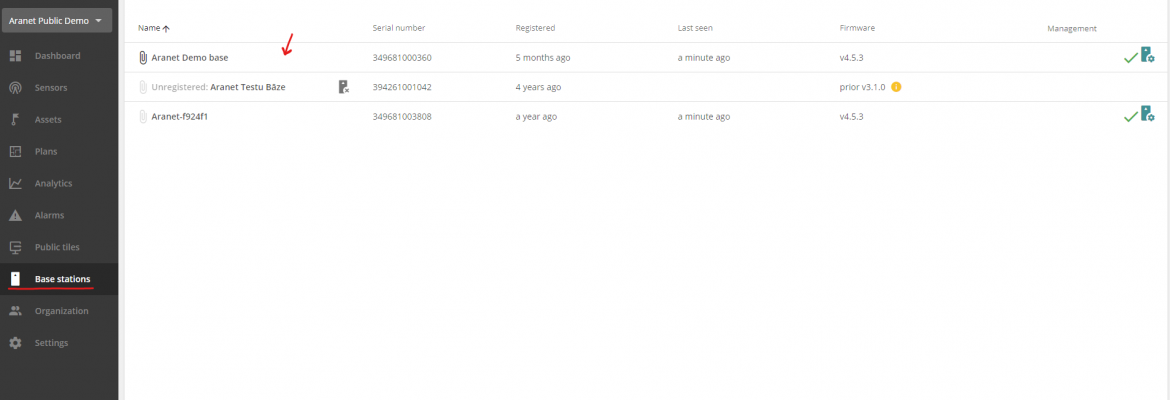

1) go to the old workspace base station section and select the base station you wish to move:

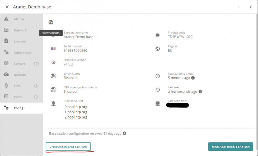

2) click on the "UNREGISTER BASE STATION" button:

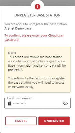

3) You should get a confirmation screen asking you to unregister the base station by providing the password. Fill in the password for the Cloud user you are using and press unregister:
Now you have successfully unregistered the base station.

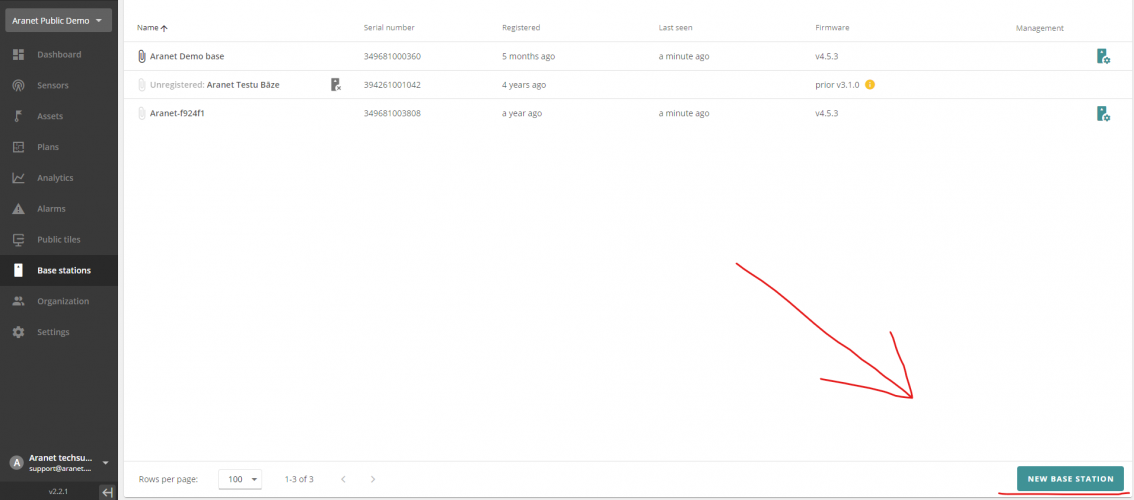

1) Go to the same base station tab in the Cloud and click on the "NEW BASE STATION" button on the bottom right:
