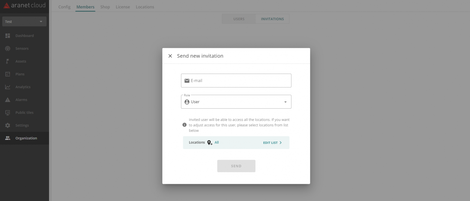

This can be done from WORKSPACE menu -> MEMBERS tab -> INVITATIONS subsection:

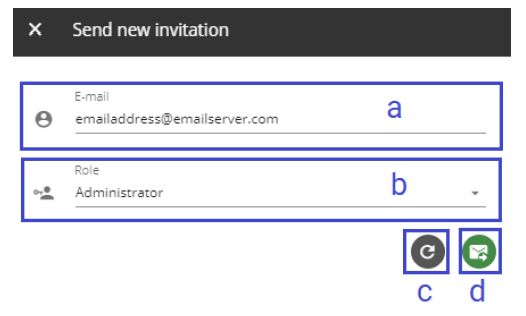

To create a new e-mail invitation press SEND NEW INVITATION button. This will open new pop-up window, where the details on the new e-mail invitation should be entered:
a. E-mail – allows specifying the e-mail address where the invitation should be sent;
b. Role – allows selecting the role (User or Administrator) that account will have in the workspace when invitation will be accepted;
c. Reset - allows resetting all unsaved changes in the window;

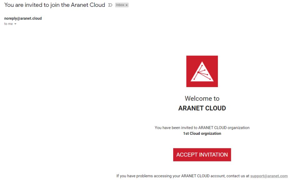

d. Send - click to send the invitation.When the invited person receives the invitation e-mail in the mailbox, she/he first needs to accept the invitation by clicking on ACCEPT INVITATION button in the received e-mail message:

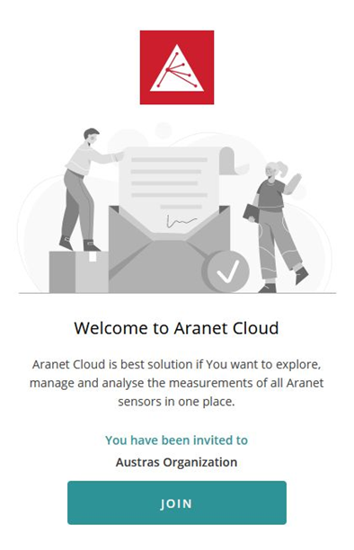

This will open a new page in the web browser where the invitation should be confirmed by clicking on JOIN button:

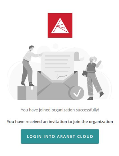

1) If the person has a registered account, then the system will offer to LOGIN INTO ARANET CLOUD.
After login the Aranet Cloud account will be switched to the workspace that the person just joined:

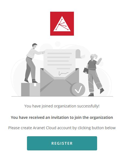

2) If the person does not have a registered account in the Aranet Cloud system, then the person first needs to register a new account in Aranet Cloud with the same e-mail address where the invitation message was delivered by pressing REGISTER button:
After registration is done the person just needs to login to the registered Aranet Cloud account to see the data from the workspace the person just joined.
