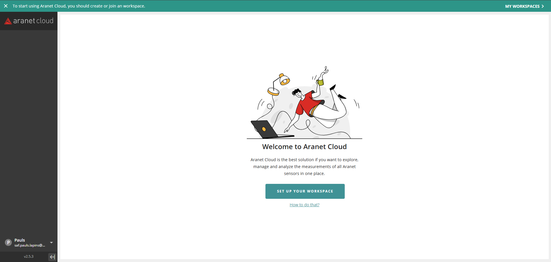

To see sensor data from Aranet PRO base stations and use other Aranet Cloud services a registered user must be affiliated with an Aranet Cloud workspace. After the initial log in the user is prompted to create a new workspace.
This process is divided into 2 steps where the user needs to:

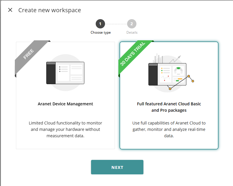

- select License type that will be used for the new workspace;
- enter Workspace information.
As Aranet Cloud services can be accessed only with time-limited licenses, the user first has to select the type of license that will be used for the new workspace:
FREE – This license is only for managing your base station remotely and does not allow you to look at sensor data or anything else. See this post: https://forum.aranet.com/aranet-cloud/aranet-cloud-device-management-license/
- FREE TRIAL– the trial license will be applied to the new workspace which will allow using it with full Aranet Cloud functionality free of charge for 30 days. Note that if an Aranet PRO base station had been previously registered to an workspace with a free trial license, then it will not be possible to register it again to a second workspace with a free trial license.

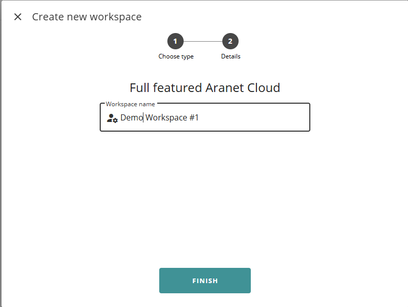

At the next step the user has to name their workspace:
Note that during the new workspace creation process user can go back to the previous steps by clicking on the digit icon of the required step, f.e.
and change his selection in these steps. If the workspace has been already created by pressing the CREATE WORKSPACE button, then it will not be possible to make changes to the Workspace type.

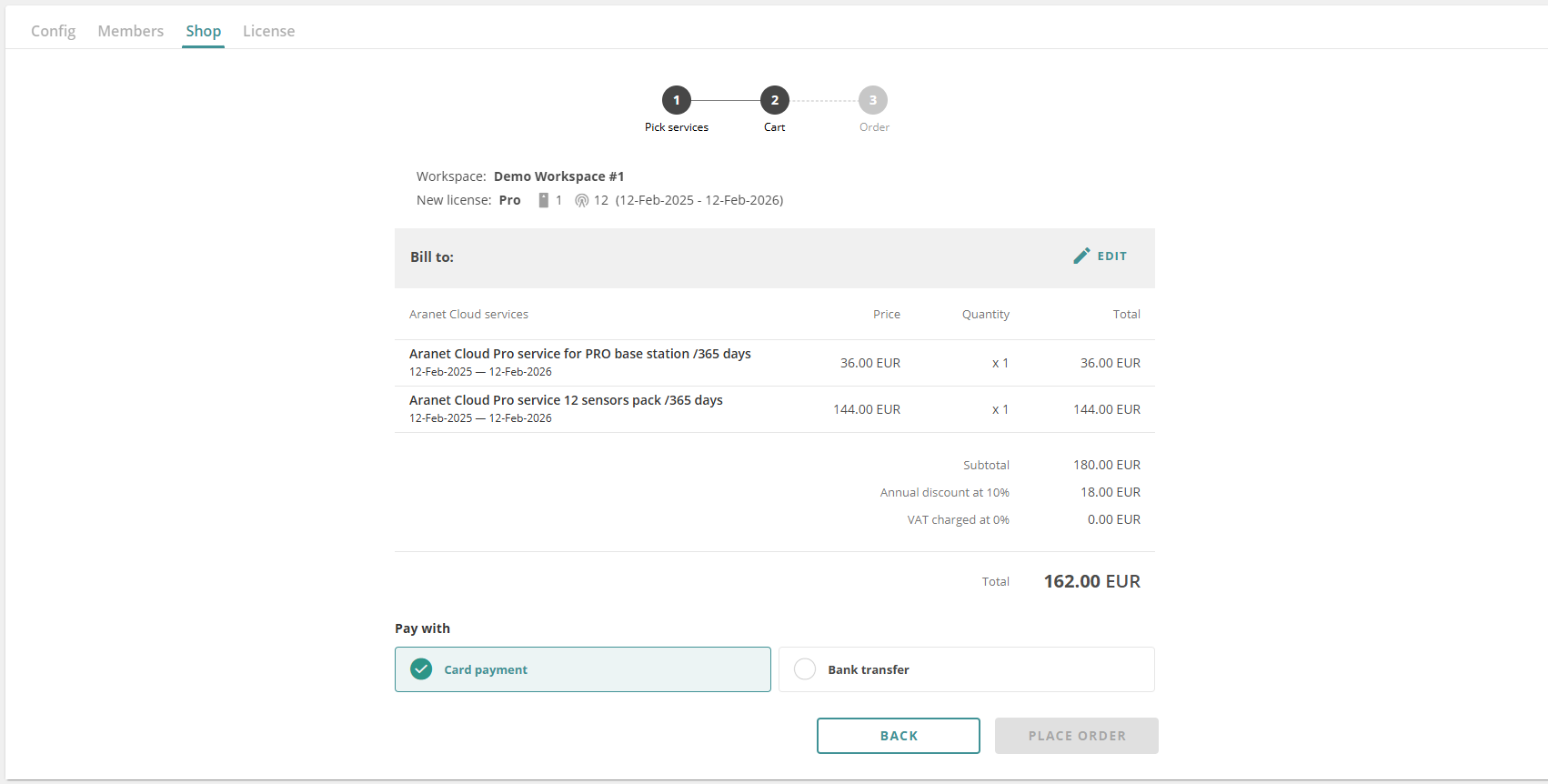

Still, it will be possible to change the workspace contacts/billing data by going to the section WORKSPACE tab SHOP and clicking the EDIT button when checking out

If the user has selected a FREE TRIAL license, it is possible at any time to update the workspace license by purchasing a time-based operational license.
