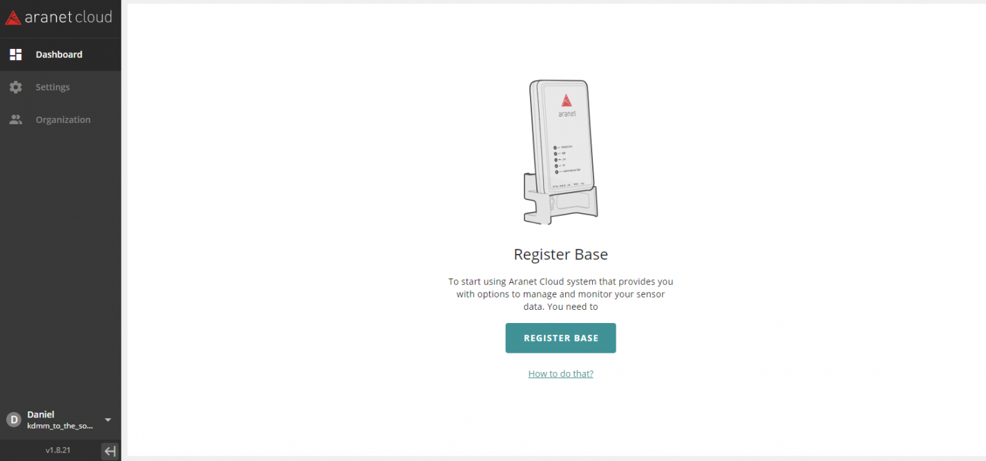

If you just created a new Workspace, go to Base stations and press ADD BASE STATION button:

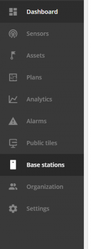

Log in with your credentials to Aranet Cloud and select WORKSPACE you wish to add a new Aranet PRO base to (you should have Administrator or Owner rights).
Navigate to the Base stations tab.
- Click on the NEW BASE STATION button.

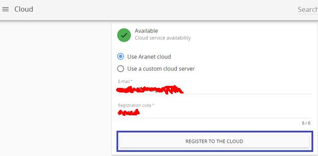

When registration code is created on the Aranet Cloud system side, then the next user must log in to Aranet PRO base station WEB graphical user interface, go to the Aranet Cloud section, and here enter in the appropriate fields the same e-mail and registration code as prompted in Aranet Cloud message. Then the user must click the button REGISTER TO THE CLOUD:

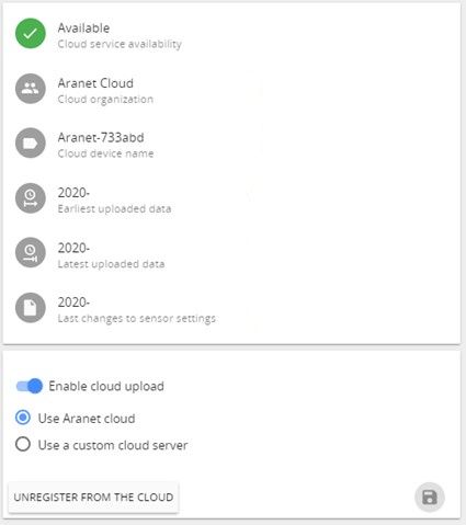

After successful registration and sensor data upload to the Aranet Cloud workspace, the Aranet PRO base station itself will show the following information in Aranet Cloud section:
Aranet PRO base will start its’ paired sensor measurement data upload to the Aranet Cloud platform. The sensor data upload process, depending on sensor data and data connection speeds between the Aranet PRO base station and Aranet Cloud system, can take up to 20 – 30 minutes. During this process, sensor data will gradually appear in the Aranet Cloud workspace.

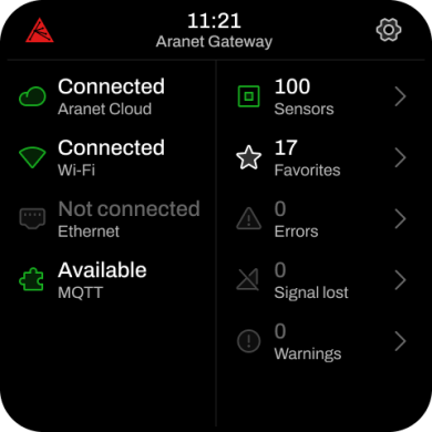

When you have successfully connected to Aranet Cloud, you will see a status "Up to date". This means that your Gateway has the latest Firmware and is Online:
On the display of Aranet Gateway Pro, you will get a message for successful connection, an icon will turn green on the Home Screen, and the status will show up as Connected:

When registration code is created on the Aranet Cloud system side, then the next user must log in to Aranet PRO base station WEB graphical interface, go to the Aranet Cloud section, and here enter in appropriate fields the same e-mail and registration code as prompted in Aranet Cloud message. Then the user must click the button REGISTER TO THE CLOUD:
ernests
Posted: 04.01.2023 14:49
Link in ProBase sensor hub UI:
http://PROBASE_IP/#!/integrations/cloud
