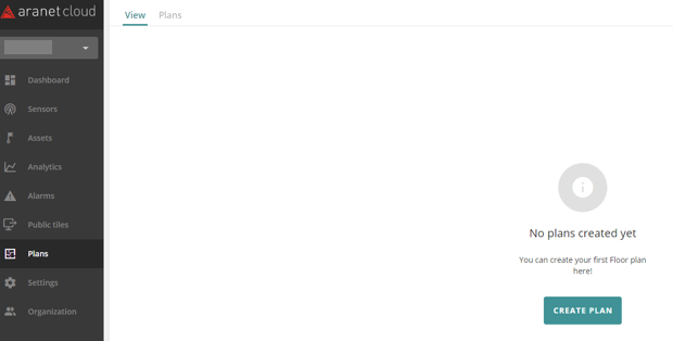

Floor plans in Aranet Cloud are created under Plans section:

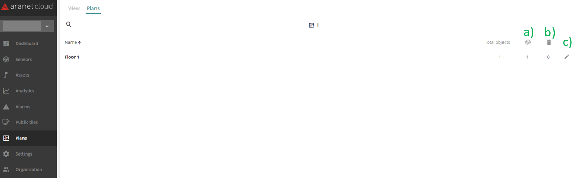

Close the plan editing window when finished placing objects. You will be returned to Plans section. Now the PLANS tab displays all created plans with information about the number of
a) Sensors,
b) Bases,
c) As well as allow their editing

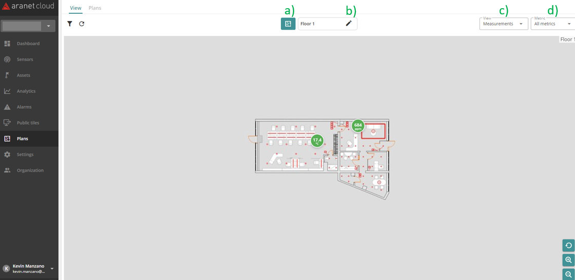

Created Floor Plans are accessible under the Plans section:
Click on:
a) button to switch between active plans
b) pencil button to edit the current plan
c) drop-down list to switch between layers displayed
d) drop-down list to select the metrics displayed: only sensors with the chosen metric (selected during object configuration, see object properties) will be displayed.
