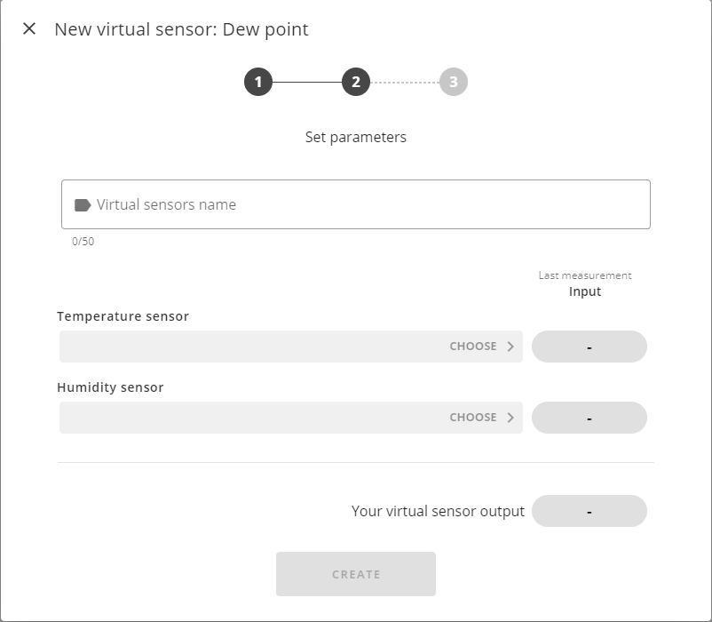

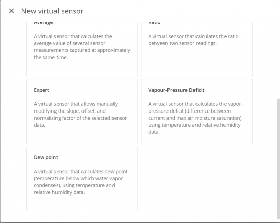

In Aranet Cloud, you can set up a Dew point sensor, which you can find under virtual sensors.
All necessary information regarding the creation of the virtual sensor and setting it up can be found in another topic: Dew Point Virtual Sensorernests
