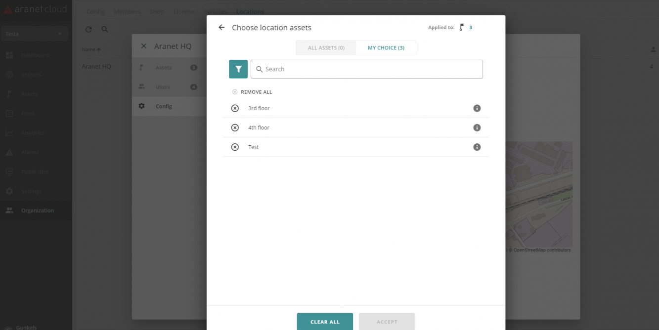

Start with creating Assets: Assets, Create Asset

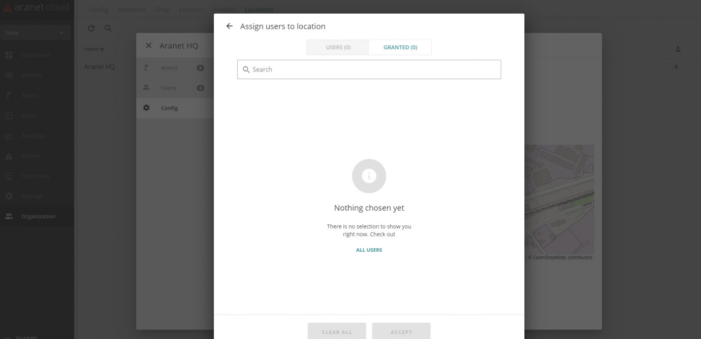

When all sensors are "distributed" over Assets, continue with creating Locations and assign the Assets to proper Locations:
When you finish configuring all Locations, your workspace members will have access only to the sensors' measurements they are interested in.
