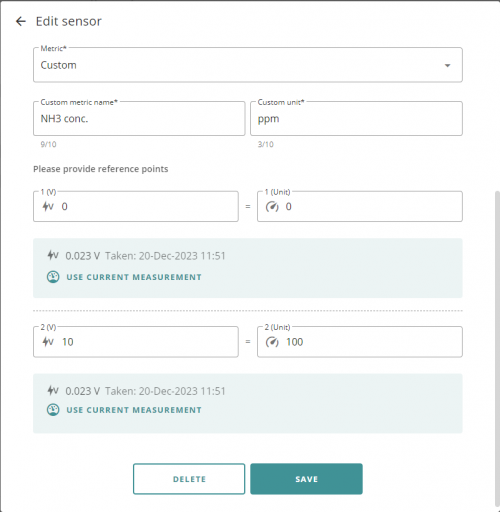

First pair the sensor with a base station, then go to the base management feature from Cloud and edit the 4-20 mA or 0-10 V sensor.
To do so from the Aranet Cloud take a look at this forum post: https://forum.aranet.com/aranet-cloud/aranet-cloud-base-management/
After clicking edit add a conversion.
From here you can choose the metric you want to convert and the unit. For this example, we are using the NH3 kit and choosing a custom metric and custom units (Although the concentration preset is available).
Afterward, you should provide reference points according to the sensor setup instructions. This time we are saying that 0V=0ppm and 10V=100ppm.
You can also use the current measurement as a reference point
You can then save the sensor edit and finish.
