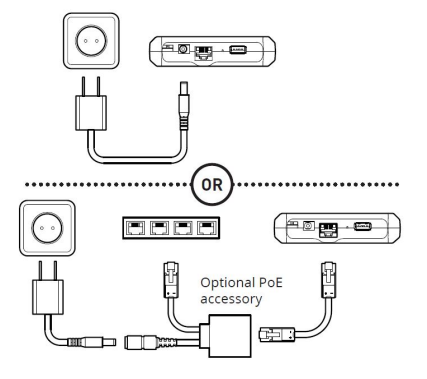

There are 2 ways to power the Aranet PRO base station:

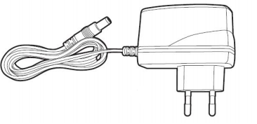

1. AC/DC power adapter - included in the original packaging box with the device:
- DC male jack size: 5.5 x 2.1mm connector, center pin positive;
- output: 12VDC and 0.5A
2. Passive PoE injector with 12V DC and 0.5A on the output and pinout wires 4-5 for VDC+ and wires 7-8 for VDC- (ground):
Pin at device Data PoE 1 Rx + 2 Rx - 3 Tx + 4 DC + 5 DC + 6 Tx - 7 DC − 8 DC − In case the Aranet PRO device is powered simultaneously via both Ethernet and DC ports, then the device will select the power supply with the higher voltage level as the active power source.
