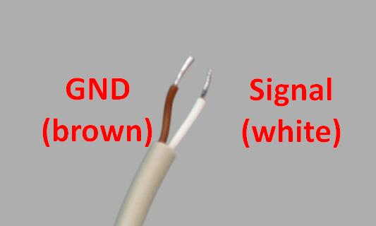

Aranet 0-10 VDC Transmitter, Aranet 4-20mA Transmitter, and Aranet Dry Contact Pulse Counter have a 2-wire cable for connection:
Wires colors are arbitrary; sensors are unipolar and have protection against wrong connections.
Anyway, based on the PCB design of the 0-10V Transmitter and Pulse sensor, you can consider the Brown wire as the Ground (GND) and the White wire as the Signal:
