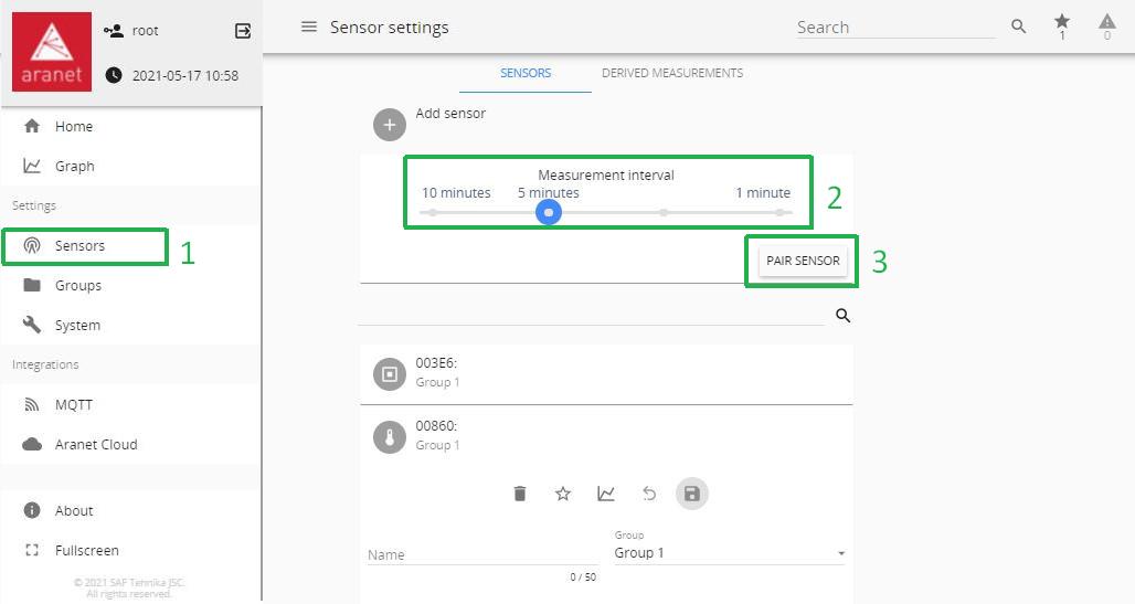

To change the measurement interval for the sensors You need to re-pair them with Aranet PRO base station. If you want to preserve measurements readings history you must not delete the sensor from Aranet Pro base, but just re-pair. Please keep in mind that pairing should be done in close proximity (< 20 meters) from Aranet Pro base station.
1. Login to Aranet Pro web-interface and navigate to Sensors.
2. Slide to set desired measurement interval.
3. Click Pair sensor and then remove battery from the sensor and place it back again shortly. When a long flash comes from LED inside the sensor immediately after the short flash, then pairing is successful. If pairing was unsuccessful, repeat pairing procedure after 10-15 seconds. Information about pairing success/unsuccess can be seen also in Aranet Pro graphical interface.
Now sensor will record new data with the new configured measurement interval in addition to the previous already saved historic data.
