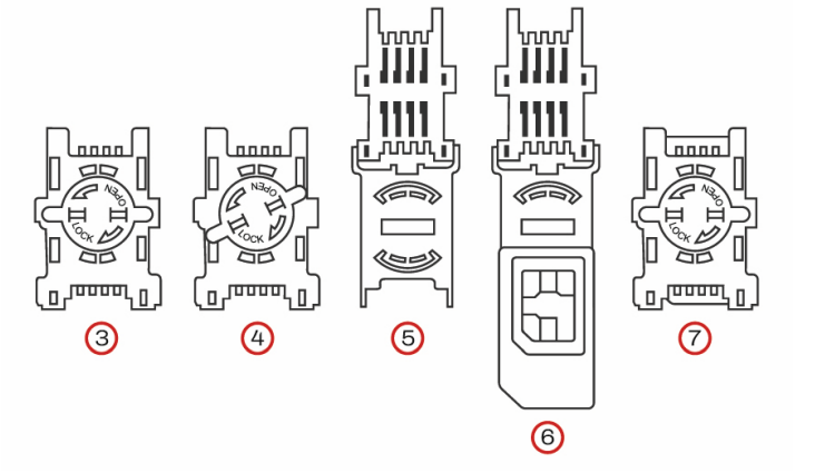

After getting the reply, that your SIM card is activated, do the following steps:(1) Disconnect Aranet PRO Plus LTE from a power source and wait for the system to shut down (all LEDs go Off).
(2) Detach Aranet PRO Plus LTE transparent lid by loosening 4 screws at the base’s case corners.
(3) Locate the SIM card holder.
(4) Loosen the holder cover by rotating the metal locking plate counterclockwise.
(5) Flip the cover off.
(6) Insert SIM-card into the cover observing correct orientation.
(7) Flip the cover back and fasten it by rotating the metal locking plate clockwise.
(8) Put back the Aranet PRO Plus LTE lid and fasten 4 screws.
