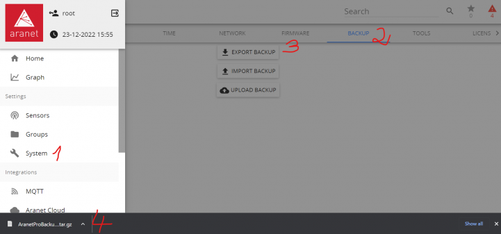

Yes, it is possible.
This can be done by pairing all necessary sensors on one Aranet PRO base station and exporting configuration backup. Then such backup configuration can be imported on an unlimited number of other Aranet PRO base stations copying/cloning the same configuration on them as present on the initial Aranet PRO base station. All cloned Aranet PRO base stations will record the data from the same Aranet sensors when they will be in the reception range of these sensors.
First you should navigate to the Base station User Interface and from there go to SYSTEM (1) -> BACKUP (2) -> EXPORT BACKUP (3). And you will get the file (4), then it should be imported into new base station. This can be done similar way: SYSTEM -> BACKUP -> IMPORT BACKUP.
Only NOTE that when the backup is imported, then the previous existing configuration on the Aranet PRO base station (if any) is deleted and replaced with the configuration of the Aranet PRO Base Station that you downloaded the backup file.
